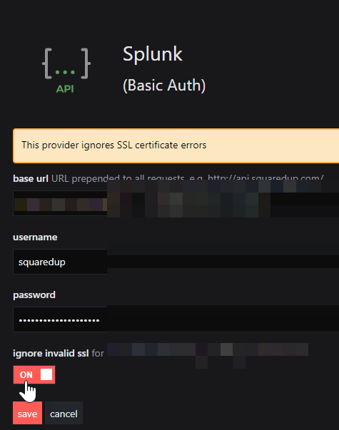

If your API service is using a self-signed certificate, then you will need to set ignore invalid ssl to ON for the provider in SquaredUp DS.
- Log on to SquaredUp DS and navigate to the right-hand menu ☰ > system > Integrations.
- Under Active Providers click on the provider you used for the Web API tile that shows the error.
- Under ignore invalid ssl click on the OFF button to change it to ON.
- Click save.
