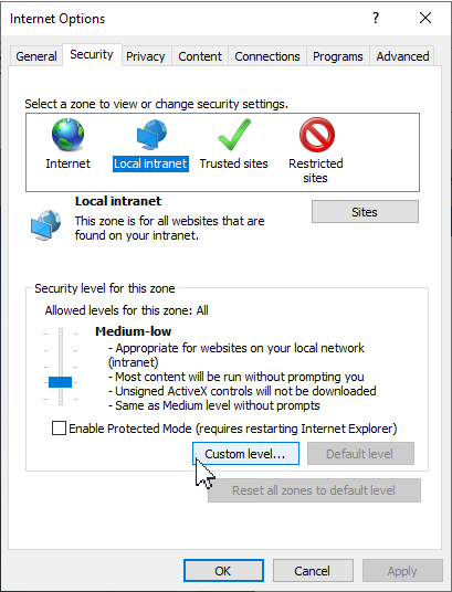

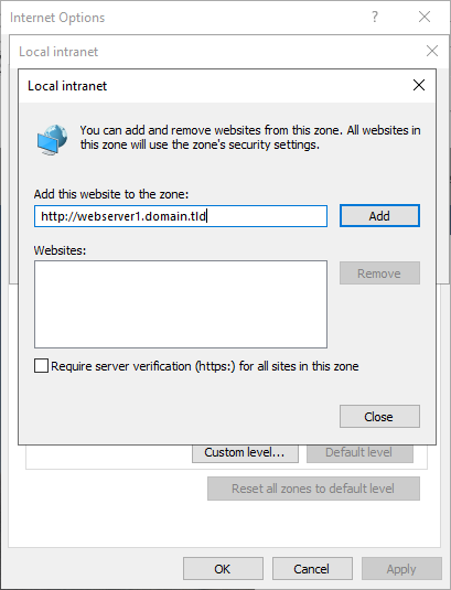

- Navigate to Tools > Internet Options > Security > Local intranet > Sites > Advanced
- Enter the fully qualified domain name (FQDN) for your SquaredUp server(s), and click Add, then Close, then OK.
When using multiple load balanced servers you must add the FQDN of each server, and also the load balanced address.
- Click on Local intranet and then Custom level

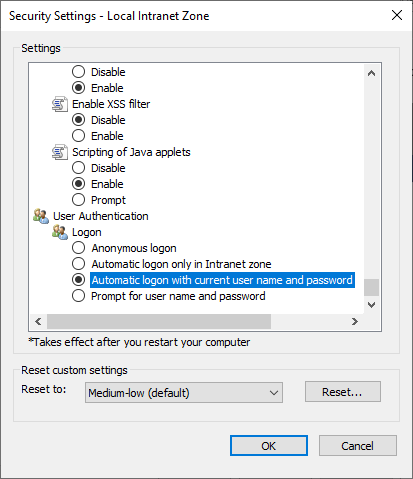

- Scroll to the bottom of the settings and verify that either of the following settings are enabled:
Automatic logon with current user name and password
Automatic logon only in Intranet zone - Click OK, then Yes, then OK.

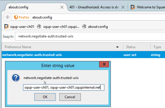

Firefox requires explicit configuration to enable Windows authentication.
- Type
about:config
in the location bar. - Type
network.negotiate-auth.trusted-uris
in the search box. - Double-click on the setting returned and type the SquaredUp server name and then the fully qualified domain name (FQDN) separated by a comma and a space. Do not include the http:// or https://
When using multiple load balanced servers you should add the FQDN of each server, and also the load balanced address.
- Click OK.
