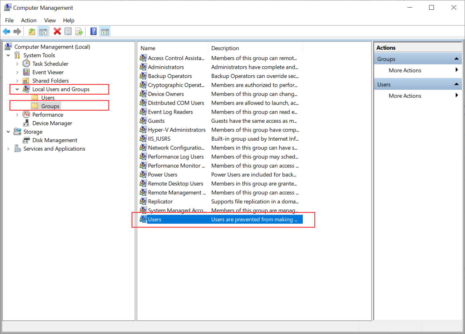

How to add a Standard User
To enable a standard user to log in to SquaredUp DS, the user needs to be added to the local user's group on the server where SquaredUp DS is installed.
- Open the Windows application Computer Management on the server where SquaredUp DS is installed.
- Go to Local Users and Groups.
- Open the subfolder Groups.
- Choose the group Users and add the user to this group. You can add a user by creating a new user, adding existing local users or groups, or adding them via Active Directory.
- When a user logs in to SquaredUp DS for the first time they will be added to the list of Named Users and consume one license, if a license is available. For more information, see How to manage Named Users
