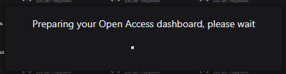

You will see the message 'Preparing your Open Access dashboard, please wait':

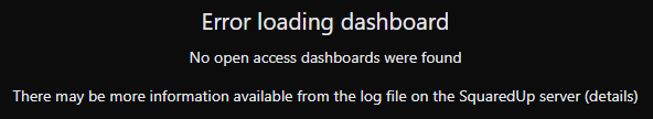

"Error loading dashboard - No open access dashboards were found"
You may see this message when viewing the open access navigation bar if all the dashboards that were on the open access navigation have had Open Access disabled or are removed from the Open Access navigation bar.

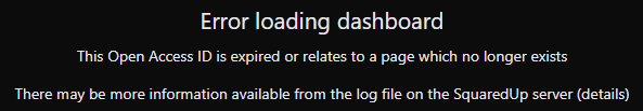

"Error loading dashboard - This Open Access ID is expired or relates to a page which no longer exists"
You may see this message when viewing an Open Access URL for a dashboard that was previously enabled for Open Access but has since had Open Access disabled.
