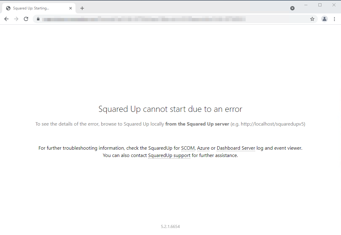

SquaredUp cannot start due to an error
SquaredUp cannot start due to an error.
Startup failed for 'Extension packs'.
In the log:
[FTL] Error during startup sequence
System.InvalidOperationException: Exception during startup sequence ---> System.InvalidOperationException: Startup failed for 'Extension packs' ---> System.Data.SQLiteException
FOREIGN KEY constraint failed
