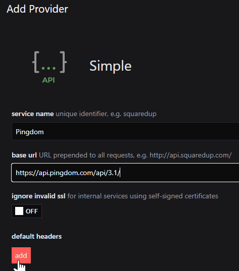

  1. In SquaredUp DS navigate to the right-hand menu ☰ > system > Integrations
  2. Under Integrations click Web API.
  3. Click the authentication type Simple
  4. In the service name box type in a suitable name, e.g. Pingdom
  5. The base URL should be the current Pingdom API URL, for example:
    https://api.pingdom.com/api/3.1/
    We recommend you include the API version here in the base URL, so if the API version changes you only need to update it here, rather than in every tile.

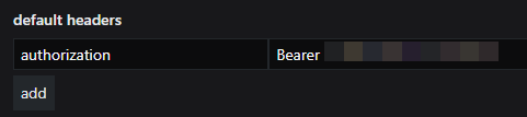

  6. Under default headers click add
  7. Add the following:
    value: Bearer <API token from Pingdom>

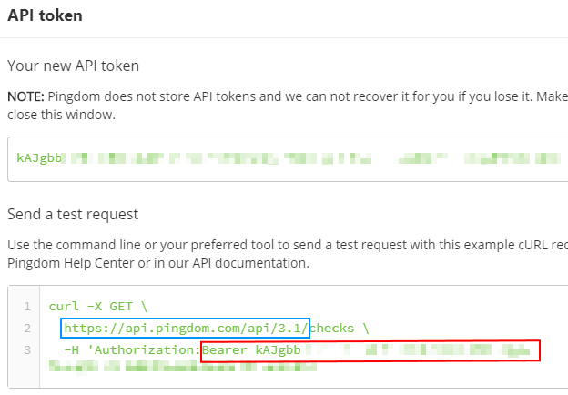

    You can create an API key (token) by logging in to Pingdom > Settings > Pingdom API > Add API token
    Enter a Name, leave the Access Level set to Read access and click Generate token.
    Copy the API token from Pingdom before closing the window:
    Paste the API token into the authorization value box in SquaredUp DS, prepended by the word Bearer and a space
  8. Click Save.
