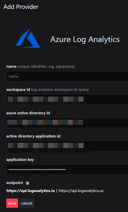

1. Create provider for a Log Analytics workspace
In SquaredUp DS navigate to the right-hand menu ☰ > system > Integrations
- Under Integrations click on Azure Log Analytics and type in a suitable name, e.g.
LondonLogAnalytics.
- In the workspace id box enter the Log Analytics workspace ID you noted down in section D above.
- In the Azure Active Directory ID box enter the Tenant ID that you noted down in section A.
- In the Azure Active Directory Application ID box enter the Azure Active Directory Application ID you noted down at the beginning of section C above.
- In the Application Key box enter the application secret value that you noted down at the end of section C above.
- Select your Log Analytics endpoint. https://api.loganalytics.ioDefault endpointhttps://api.loganalytics.usUS Government endpoint

- Click save.
