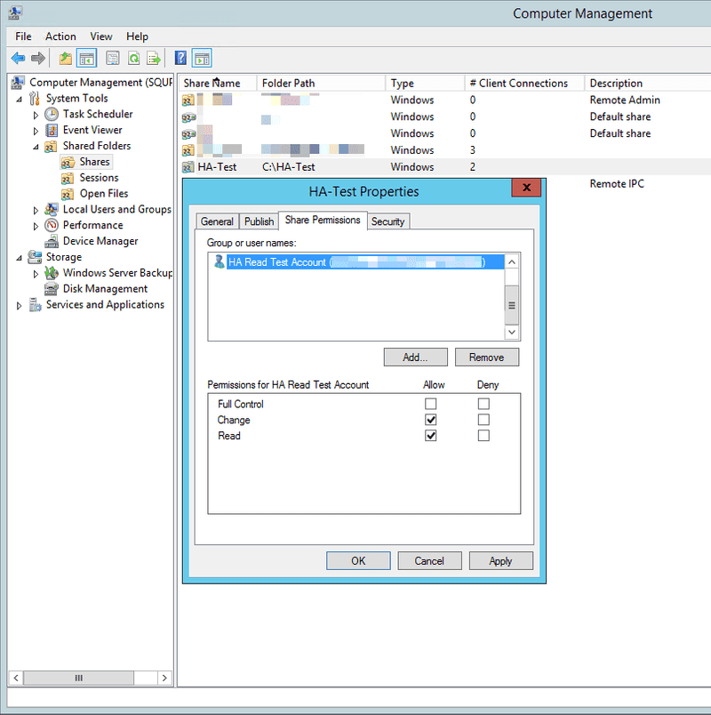

Configure permissions on the share
Before configuring HA it is important to check the permissions on the share itself. The share has its own permissions which cannot be viewed via Windows Explorer, and they always take precedence over the file and folder permissions. If the SquaredUp DS application pool identity (How to check and modify the application pool identity) is not allowed to read and change, then the permissions added to the folders by the SquaredUp command are overridden/ignored by the share, and SquaredUp DS will fail to start with an 'Access denied' error.
In Computer Management check that the SquaredUp DS application pool account has 'Read' and 'Change' permissions to the share itself, as described below:
- On the machine that hosts the share, click on the Start button > type
Computer Management> open Computer Management. - Navigate to System Tools > Shared Folders > Shares.
- Right-click on the SquaredUp share and then on Properties.
- On the Share Permissions tab, check that all SquaredUp DS application pool accounts have read and change permissions:
- If your servers are using a domain service account as the SquaredUp DS application pool identity (How to check and modify the application pool identity) then this account should be given read and change permissions.
If your SquaredUp servers are using Network Service as the SquaredUp DS application pool account (How to check and modify the application pool identity), then all the machine accounts for the SquaredUp Primary and Secondary servers should be given permissions, for example,Squpserver01$andSqupserver02$.
It should not be necessary to grant full control, and this could pose a security risk.
